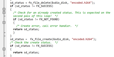

2025-12-02 1:58 AM
Hello @Will_Robertson
In this example a file called "encoded.h264" is created in the SD card.
To read back encoded video, it can be converted from raw bytestream to mp4 using a tool called ffmpeg with the following command : ffmpeg -f h264 -framerate 30 -i [extracted file] -c copy [output file]
2025-12-02 1:58 AM
