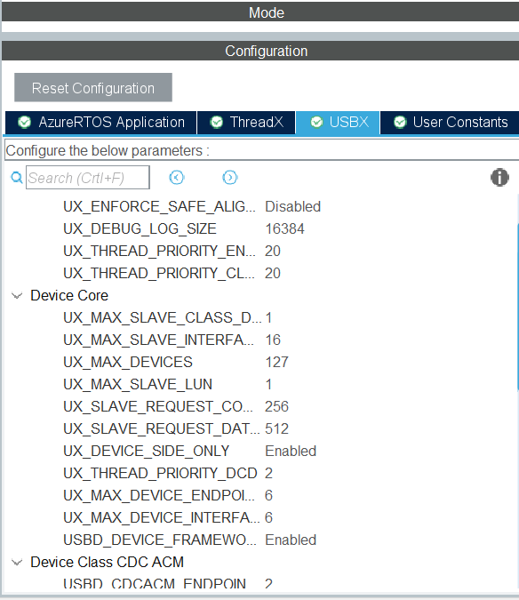

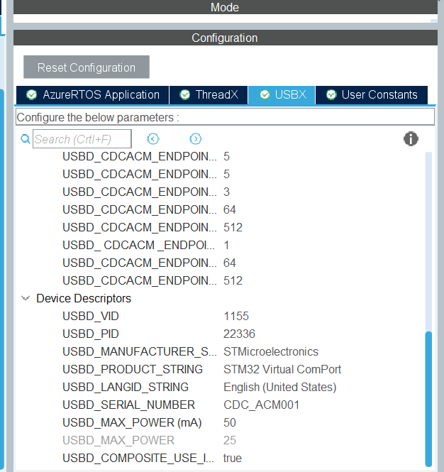

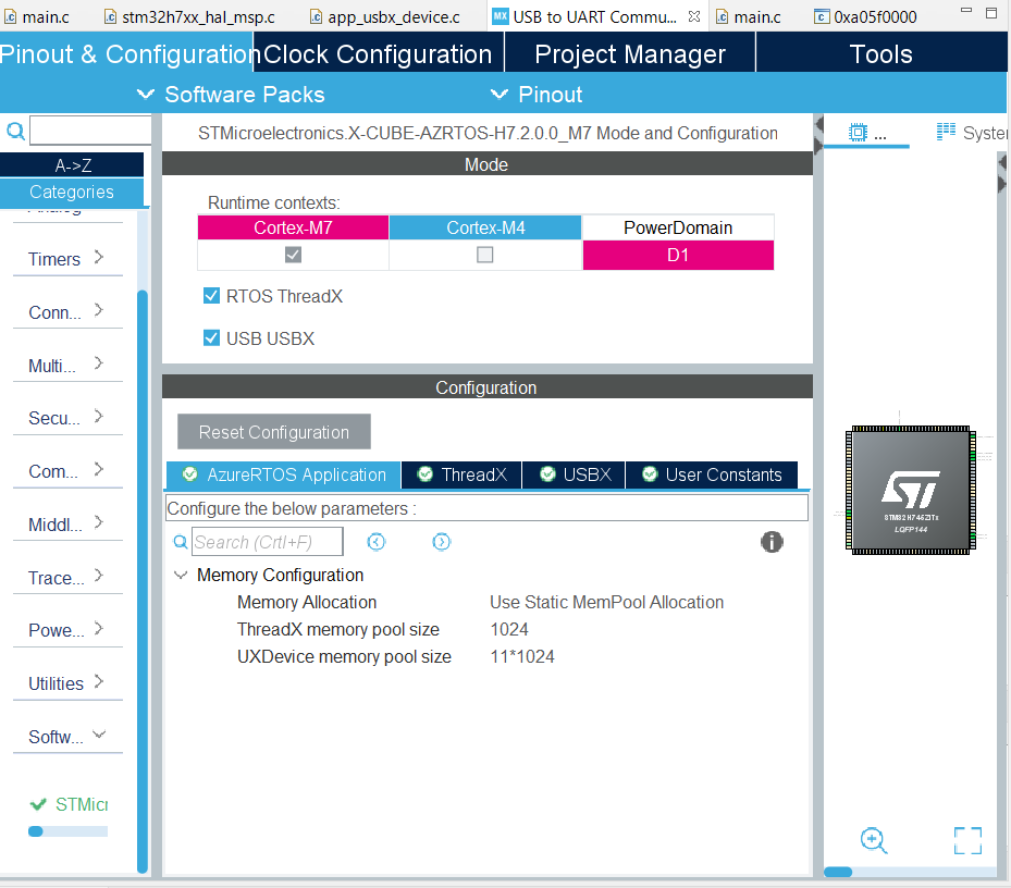

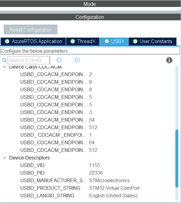

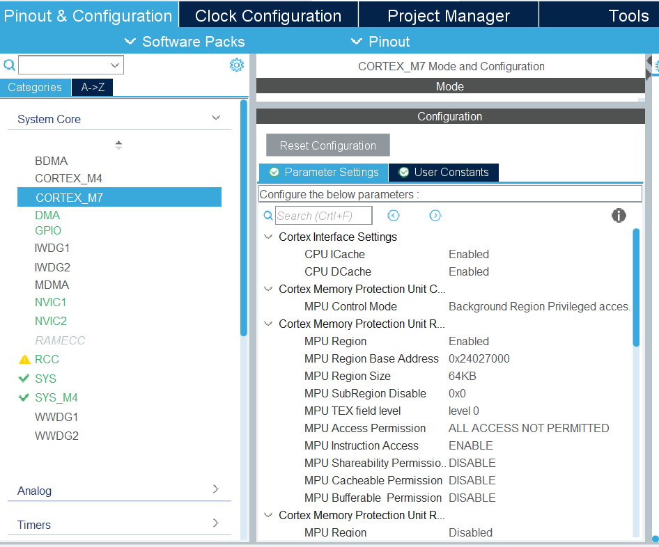

I am working on Nucleo-h745ziq board. The example provide in cubemx of Ux_Device_CDC_ACM accordingly I create the example for Nucleo-h745ziq board. The changes I make that instead of HS I select Fs mode because board support the FS mode and disable the MPU protection because it gives problem for CM4 core. When I connect two usb only STLINK Port recognize user USB port is not get updated. I share the setup things,

Why the port is not get updated the Device driver? Can you help me. Because I am newly work on Azure Rtos I don't have much knowledge of it.
2021-11-22 10:40 AM
Have a look at the example "Ux_Device_HID_CDC_ACM" provided within the AZRTOS-H7 pack it is using the STM32H747-DK board similar to the one you are using.
