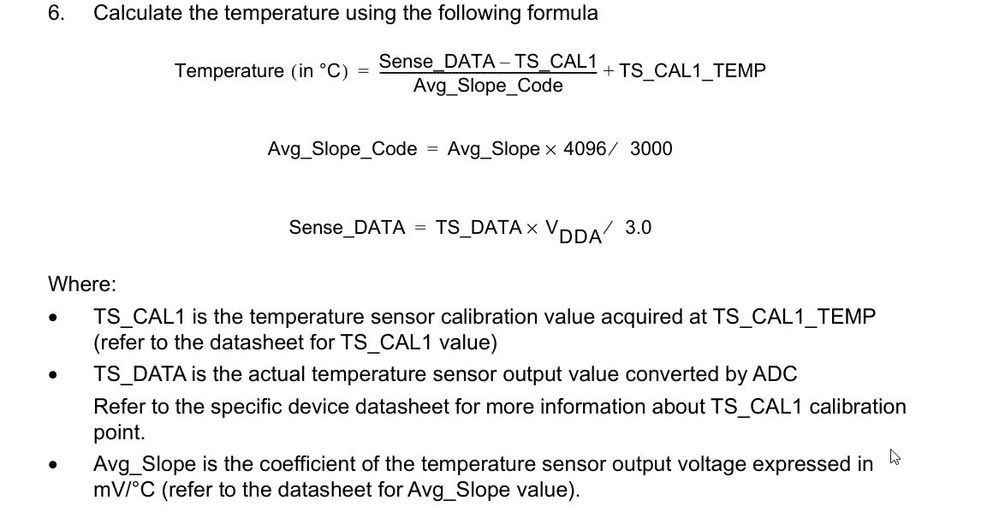

2025-04-15 5:14 AM
using the datasheet and trying to do it manually (screenshot below):
Avg Slope Code = 2.53 x 4096/3000 = 3.45
sense data = 787 x 3.3 / 3 = 866
TS_CAL_1 = 1048
Temp = ((866 - 1048) / 3.45) + 30 = -23
I am just putting the numbers into the equation, exactly as described, so something is incomplete or unclear here.
2025-04-15 5:20 AM
Well, the 787 you quote as raw value does indeed correspond to -20°C, according to the calculations given in the manual. Using the t_cal1 value it's -22.8
I would expect to see an ADC count of around 1030 at 25°C
