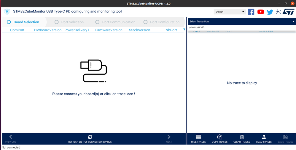

It is described in the Wiki(link).
On the start screen, click on the button "TRACES" in the right bottom side.
It will open the trace panel.
Then click in the dark blue bar on the top right to "select Tracer Port" as in the below picture :
You should normally see in the drop down list your Linux serial port : /dev/ttyACM0 or similar.
Of course, you shouldn't move the door position while tracing, because the software running is completely different whether you have the door closed (sink mode) or open (spy mode)

2022-03-15 3:57 AM
Hello @RZitz
Not sure to understand how you proceed. Having the door open, you cannot have the board listed in the board selection part. (For the details, when you are in spy mode, the GUI part is not started, therefore, the board will not answer to the UCPD monitor pings. ie Rx on the board is not enabled) But ... you can still have the protocol traces (Tx on board active as long as TRACER_EMB enabled).
With G0 disco in spy mode, you have to manually tell which COM port has to be used.
See the Wiki for more information.
