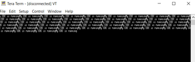

Still trying to get USBX to work, I can now get data out to Putty but it's all garbage and after each send it "dings" (very annoying). I used the H5 example to get it working, last hurdle I guess. Putty is set to 115200, 1 stop bit, 8 data bits just like the configuration:
#define MIN_BAUDRATE 9600
UX_SLAVE_CLASS_CDC_ACM_LINE_CODING_PARAMETER CDC_VCP_LineCoding =
115200, /* baud rate */
0x00, /* stop bits-1 */
0x00, /* parity - none */
0x08 /* nb. of bits 8 */
Anything else I can check? This is what I'm seeing:

Ensure that your USB connections are secure and that there are no loose connections. Sometimes, a faulty USB cable can cause data corruption. Ensure that the buffers used are not corrupted in memory.

I switched cables and ports with no better result. However, stepping into the method, _ux_device_class_cdc_acm_write, it fails because it thinks the device isn't configured:
/* As long as the device is in the CONFIGURED state. */
if (device -> ux_slave_device_state != UX_DEVICE_CONFIGURED)
/* Error trap. */
_ux_system_error_handler(UX_SYSTEM_LEVEL_THREAD, UX_SYSTEM_CONTEXT_CLASS, UX_CONFIGURATION_HANDLE_UNKNOWN);
/* If trace is enabled, insert this event into the trace buffer. */
UX_TRACE_IN_LINE_INSERT(UX_TRACE_ERROR, UX_CONFIGURATION_HANDLE_UNKNOWN, device, 0, 0, UX_TRACE_ERRORS, 0, 0)
/* Cannot proceed with command, the interface is down. */
return(UX_CONFIGURATION_HANDLE_UNKNOWN);
My device -> ux_slave_device_state is 0. I haven't figured out why it doesn't think it's configured. Maybe that is my problem?

I've gotten nowhere with this. I used the same cable and port on a f446 Nucleo board, NOT using USBX and the string is written out to the terminal window just fine. Try USBX on the U535 and it's all garbage. And one other thing I noticed, if I don't put a '\r\n' at the end of the buffer, it doesn't even attempt to write out garbage, it does nothing.
I debugged into the LL code and the buf is correct, doesn't look like the data is corrupted in any way.
If someone out there has a U535 would you be so kind as to load the attached CubeIde project and see if it writes out garbage for you as well? Would be greatly appreciated.

It seems you are mixing FDCAN semaphore while configuring USBX CDC stack. Follow the example provided in standalone.
It is working on my end using Nucleo U545.
