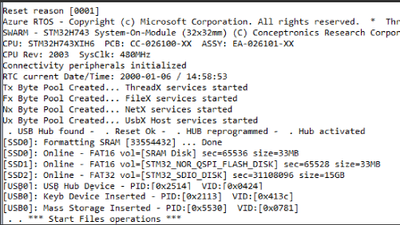

Ok, I finished re-writing the Host Only and Device Only drivers, and it seems to be working properly now. The H7 works with a hub and multiple devices on the host side. I still have to test the Device side next week, but hopefully that will be a bit easier.
ST should update their middleware code so users don't have to go through all this pain.

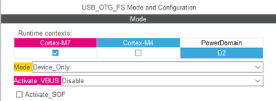

2- open the Ux_Host_HUB_HID_MSC.ioc and add a peripheral: USB_OTG_FS amd make it "Device only"

8- Note: ONLY: In app_azure_rtos.c you will see 2 instances of USBx, one for the host, and the other for the Device
9- compile and run.... you will notice that the entire code is flakey because of the way the initialization code is defined... So all the main USB structures are not initialized like _ux_system, and _ux_system_host.

Thanks for the info... I finally got the USB initialization code re-written properly and it generates separate memory pools for the usb host and device using the two H7 USB interfaces. That way, I can still configure the hardware using the existing CubeMX GUI. I also found a hack for CubeMX, so it doesn't update the code for certain files that needed to be modified (outside of the "user comment" sections).
I'm currently in the process of testing the USB host side with a hub and multiple devices (keyb, mouse, Storage), and looking at the issue of the internal H7 USB state machine locking up (as described in the errata). I think we have a work-around for that and hope I can fix that issue in a couple of days.
Once I finish testing the Host side, I'll jump on the device side testing. It is currently compiled in and all resources allocated, but I still have to test and debug. I can enable device only, host only, and both device only and host only from the CubeMx GUI and it seems that the resources are all allocated properly now.
