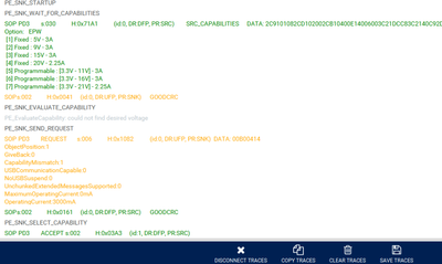

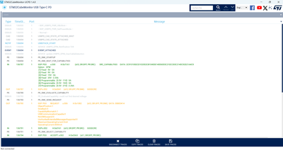

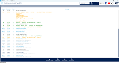

Yes, I have checked systick is working as expected. I am able to get the traces as shown below:
I am unable to get the .cpd file, just captured the traces in UCPD monitor. I am using monitor - UCPD 1.4.0
