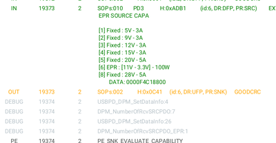

I've also found strange behaviour in the stack.
After receiving PDOs in EPR mode, it calls USBPD_DPM_SetDataInfo with USBPD_CORE_DATATYPE_RCV_SRC_PDO with the Size of SPR + EPR PDOs, but empty last PDOs, which corresponds to EPR ones.
Is it a bug?

Yes, case USBPD_CORE_DATATYPE_RCV_SRC_PDO_EPR is handled separately. But the problem is inside USBPD_CORE_DATATYPE_RCV_SRC_PDO (non-EPR), where
DPM_Ports[PortNum].DPM_NumberOfRcvSRCPDO = (*Size / 4U);can't work properly after entering EPR_Mode, as the stack returns Size = 28, 28/4=7; however, SPR has only 6 PDOs and 1 EPR PDO.
I've workaround it as
uint32_t pdos_cnt = 0;
for (uint32_t index = 0; index < (Size / 4); index++)
rdo = (uint8_t*)&DPM_Ports[PortNum].DPM_ListOfRcvSRCPDO[index];
(void)memcpy(rdo, (Ptr + (index * 4u)), (4u * sizeof(uint8_t)));
if (*rdo != 0) {
pdos_cnt++;
DPM_Ports[PortNum].DPM_NumberOfRcvSRCPDO = pdos_cnt;
