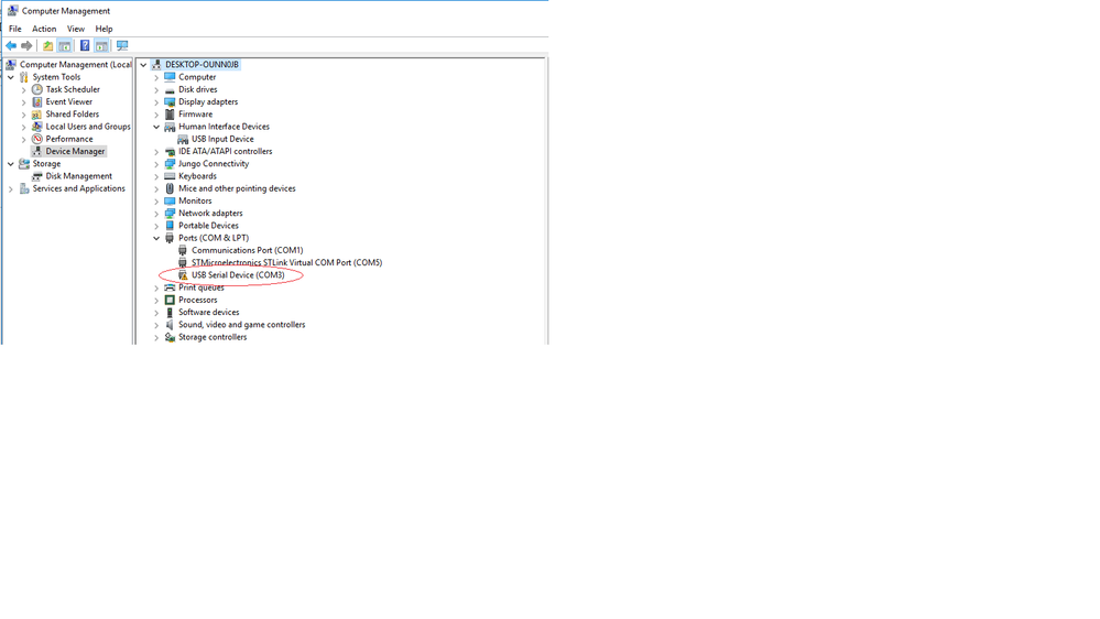

Since I am using windows 10 , its not necessary of drivers in PC side as per your suggestion. To start with I need make simple echo device (device should receive data from PC and echo the same to PC), For this Do I need to make any changes to standard USB device VCOM example(which I generated through STM32 cueMX tool).
>> Usb device is detecting in PC as Virtual com port device , but It can't accessible through any application(like hyper terminal,tera terminal).
I have attached the screenshot of device manager, can you please look and sort out the issue.

,on Windows 10, there is no need for a virtual com port driver to be installed. It is loaded by default when you plug-in a device.But according to Microsoft documentation, you need to set class and subclass ID to 0x2 (see
https://msdn.microsoft.com/en-us/library/windows/hardware/dn707976(v=vs.85).aspx
.This should be also fixed in some of our HAL/CubeMX examples.

Hi
Lecoutre.Cedric
Yes it is right that its not necessary to load any driver, but my doubt is why that warning coming (screenshot attached in last message). And also the virtual com port shown in device manager is also not accessible in applications (like HyperTerminal), If it is accessible then I can transmit and receive data .

It looks to me, you do not use COM5, not the ST-LINK VCP device, instead you have developed your own VCP (CDC) based on the STM FW/sample/CubeMX and using the user USB port for it ... - if device driver does not start (yellow flag on it) - potentially an issue with your USB Device Enumeration (MCU sends incorrect USB enumeration, classes, PID/VID do not match or still a need to install the STM VCP driver (I could not see anymore a download link on STM site)).
I would start with an USB analyzer, e.g. USBlyzer:
and check if you see errors in USB enumeration.Check also if the PID/VID, the classes sent via the USB Enumeration are correct, e.g. this class 2, subclass 2 as requested by the Windows 10 VCP/CDC driver. Pretty sure, USB Enumerations (all your USB descriptors defined in USB CDC) is the main reason.2017-09-15 12:21 PM
