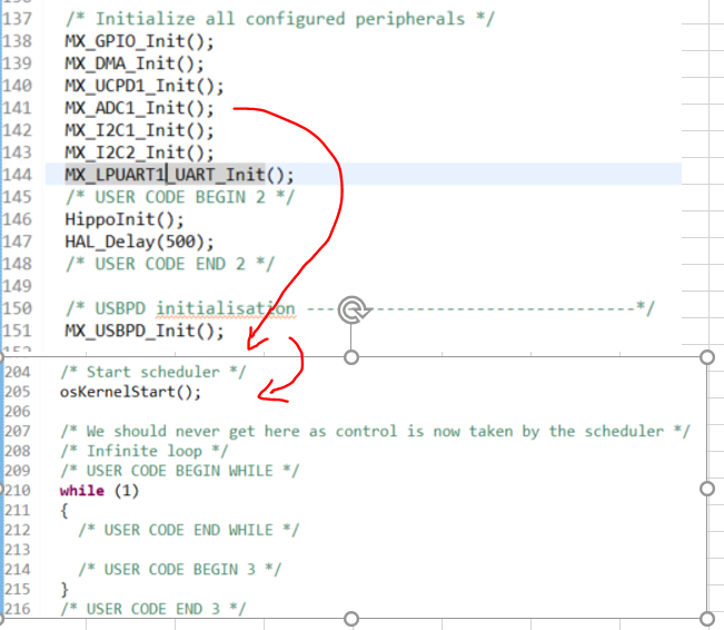

2024-12-11 2:14 PM
I have a similar situation. At certain times my device is not capable of providing a charge so it should be SNK only. When it can provide a charge it should be DRP toggling. But this driver doesn't allow that. You must pick a mode and stick with it.
1. You are always a SNK.
2. You are always a SRC.
3. You are always DRP (toggling).
