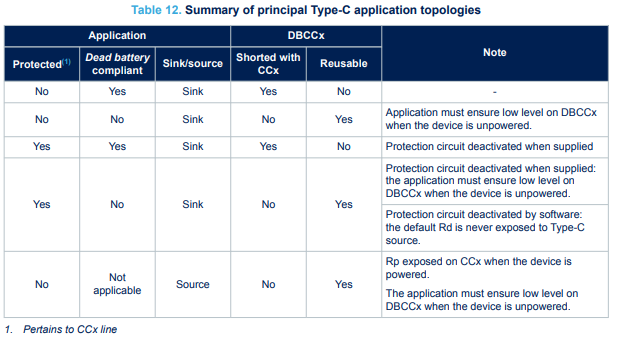

In AN5225 - Rev 5, there is a chapter describing DBCCx usages from system point of view:
11.2.1 DBCC1 and DBCC2 lines
Have a look in following table:
Table 12. Summary of principal Type-C application topologies
