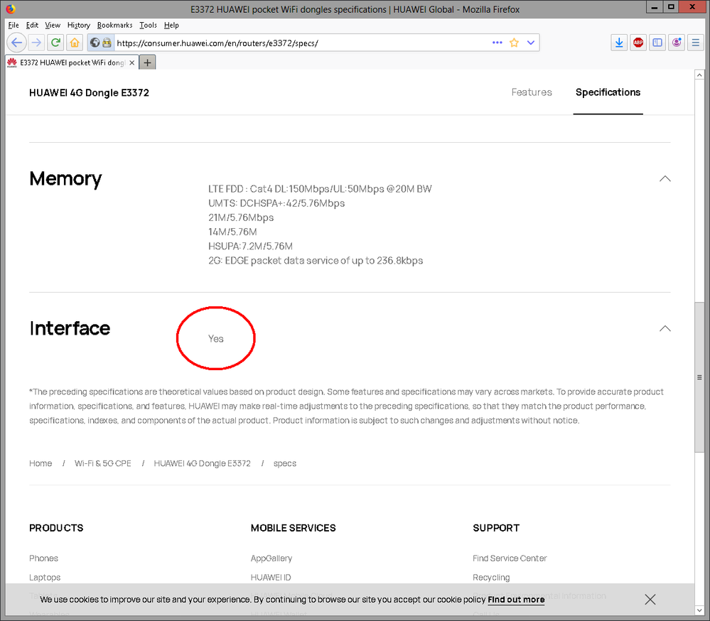

2020-05-31 2:31 PM
This is what the manufacturer had to say in this regard, verbatim:
