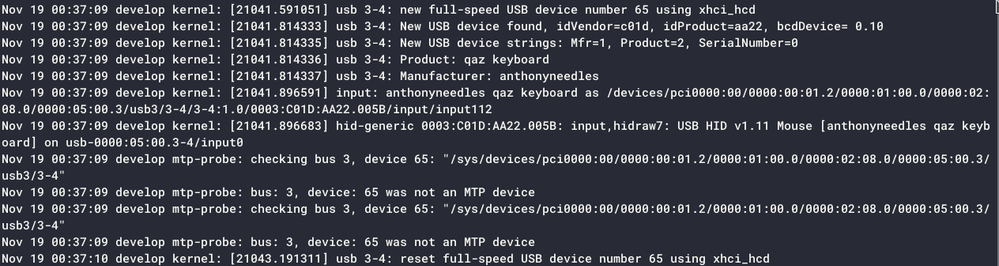

I'm doing the testing on a Debian machine. This is the output of `tail -f /var/log/syslog`:
As you can see, the host gets the string descriptors, and identifies the device as an HID Mouse device. But I resets right at the end (I'm almost positive the mtp-probe stuff has no effect).

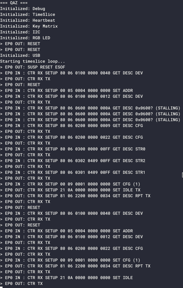

Here is the output from the serial debug output:
The format of the printouts is:
We can see the device proceed through enumeration, get to the Get Descriptor, Report request then immediately `RESET`.

The last log record was CTR TX. Was it a control request?
