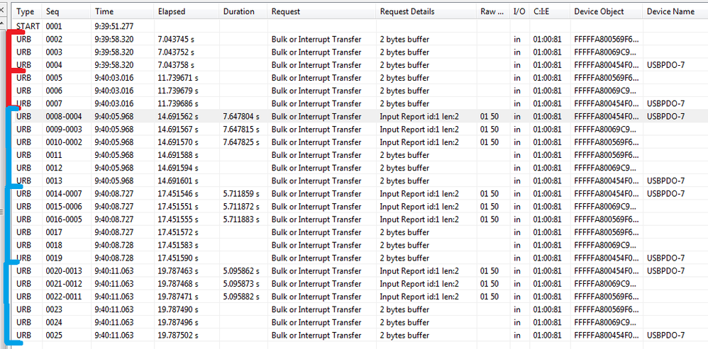

Writing about loss of data I thought about such kind of situation:
In main.c inside while loop I've got some condition to chceck if the button is clicked, if yes I'm sending data as you show above. After first few click (two or three) I don't receive any correct data (which is buffer[] = {0x01, 'P'}) but after that I receive too many data (duplicated). You can see it in included screenshot of USBlyser sniffing (first incorrect data marked red next three marked blue (each one should be only 0x01,0x50)).
P.S I'm using library V2.2 so I haven't got any bad implementation in SysTick or Callback as you mention.
You are interpreting the USBlyzer log wrongly. The #0002 - #0004 three lines represent just a single transfer request, which sequentially goes down three components on the host driver stack. This request is pended, until #0008 - #0010 lines come. Though you’ve cut off the log table, you should see the same IRP value on these three lines. Also #0005 - #0007 are the second request, which is also pended. #0008 - #0010 lines are the completion of the first pended request (#0002 - #0004) #0011 - #0013 lines are the third pended request, reusing the first IRP object. #0014 - #0016 lines are the completion of the second pended request (#0005 - #0007) #0017 - #0019 lines are the fourth pended request, reusing the second IRP object. etc. Windows keep two outstanding requests for the interrupt IN EP of HID device, to ensure 1 ms interval. PC host controller defers the hardware interrupt of transfer completion just at the end of the frame (ie. the next SOF timing), in which the transfer completes. And then, single request can’t keep 1ms interval. In this reason, Windows apply two outstanding requests. There is nothing particular on your log. It’s a typical one for HID devices. After all, you are seeing just a ghost. > P.S I'm using library V2.2 so I haven't got any bad implementation in SysTick or Callback as you mention. What is ''library V2.2'' ? ST has released STM32_USB-Host-Device_Lib_V2.1.0, but no v2.2 This library has also wrong HID implementation using SysTick_Handler() I believe it is exactly your problem.
\STM32_USB-Host-Device_Lib_V2.1.0\Project\USB_Device_Examples\HID\src\system_stm32f2xx.c
void SysTick_Handler(void)
uint8_t *buf;
buf = USBD_HID_GetPos();
if((buf[1] != 0) ||(buf[2] != 0))
USBD_HID_SendReport (&USB_OTG_dev, // <--------------
buf,
4);
Tsuneo
