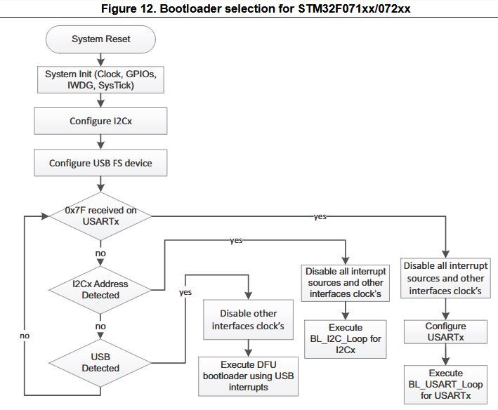

I can't figure out why sometimes it works and sometimes it does not as I do not change my code from one try to another. I suspect that this might be due to the fact that I have 1 I2C peripheral and 2 UART peripherals connected to my STM32F072 and thus my bootloader does not always reach the execution of DFU bootloader using USB interrupts according to the bootloader selection mechanism described in figure 12 of AN2606.

I am using the HAL drivers in my application and I did not change the default value for both HSE and HSI (HSE_VALUE is 8Mhz, HSE_STARTUP_TIMEOUT is 100ms, HSI_VALUE is 8MHz, HSE_STARTUP_TIMEOUT is 100ms) in the 'stm32f0xx_hal_conf.h' file. The clock related to the USB (HSI48) is set to 48MHz, which I believe is the correct value to use USB FS. I will try to modify those values to see if there is an impact on the bootloader.
