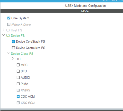

You are invited, to use Azure /ThreadX . :)
Here (threadx activated) you can choose ... :

Hi @VKoen.1
Which USB stack do you want to implement? If you are using ST Library stack, it is not implemented in CubeMX. You can check examples provided here.STMicroelectronics/stm32h5-classic-coremw-apps: Provide a set of applications for STM32H5xx series based on the STM32 Classic Core Middleware libraries. (github.com)
