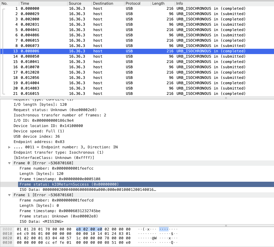

Hi, I am trying to get a robust isochronous transfer of audio from my STM32F072CB using the audio device class. My code is based on the code generated by STM32CubeMX for a speaker but I have changed the descriptor in order to make it an audio input. Basically all I have changed is usbd_audio.c and usbd_audio.h. I am sending 120 bytes on each DataIn interrupt (which I have confirmed occurs every millisecond) but when I record from this source, I only get 50% of the data and if I look at the USB trace using WireShark I can see that all my packets have errors and every second packet has no data! I have managed to find a few examples such as the X-CUBE-MEMSMIC1 example and as far as I can tell I am doing the same thing they are. Any help to get a reliable audio data transfer much appreciated!
