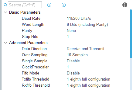

Thanks for the quick response -- it's much appreciated. Hardware connection should be there (USART 3 is connected to the virtual COM port on the PCB from the STM32H745I-DISCO datasheet). Jumper is set to power off the STLink USB Port (CN 14), which is plugged into my computer. Clock is set to 100MHz with an 115200 baud rate set in the CubeMX GUI. A 100MHz clock should be fine to clock data at that baud rate right? The project also has TouchGFX added, so that task is running as well. It shouldn't affect anything since I have the UART task set to preempt TouchGFX.
