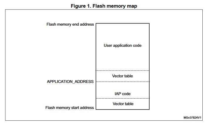

I have just read AN4657 (STM32 in application programming iap using the usart) and the LwIP IAP example. AN4657 document explains how IAP works but I still do not know how to write the IAP code and the main program. I guess I have to modify the linkerscript but I do not know how to do it.

Our client needs to update the device using HTTP (DLMS over TCP/IP). The firmware must be updated by connecting a computer to the device or remotely. The LwIP IAP example is very helpful, as it allows to update the firmware using TFTP and HTTP.I think I am going to adapt the example to my project.
