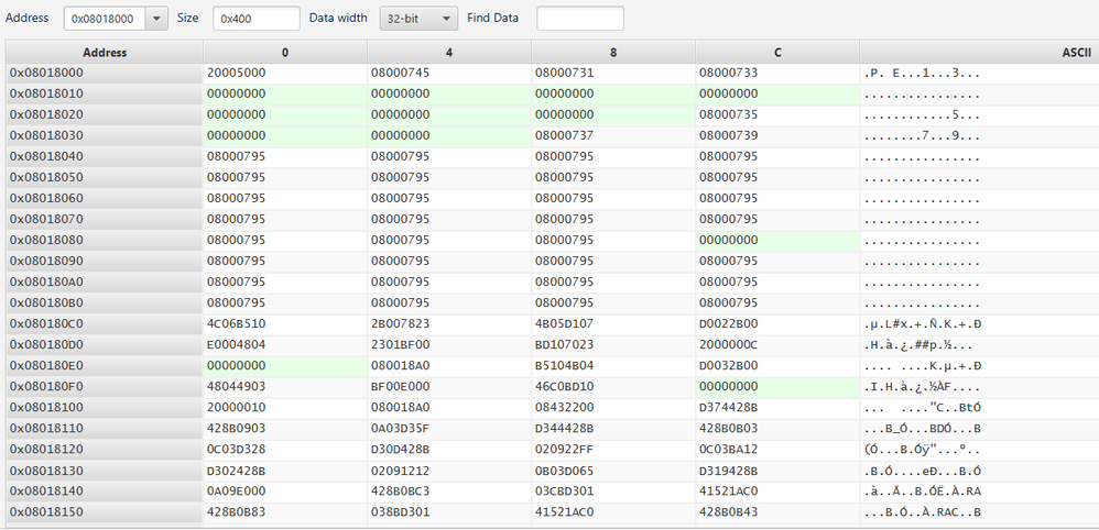

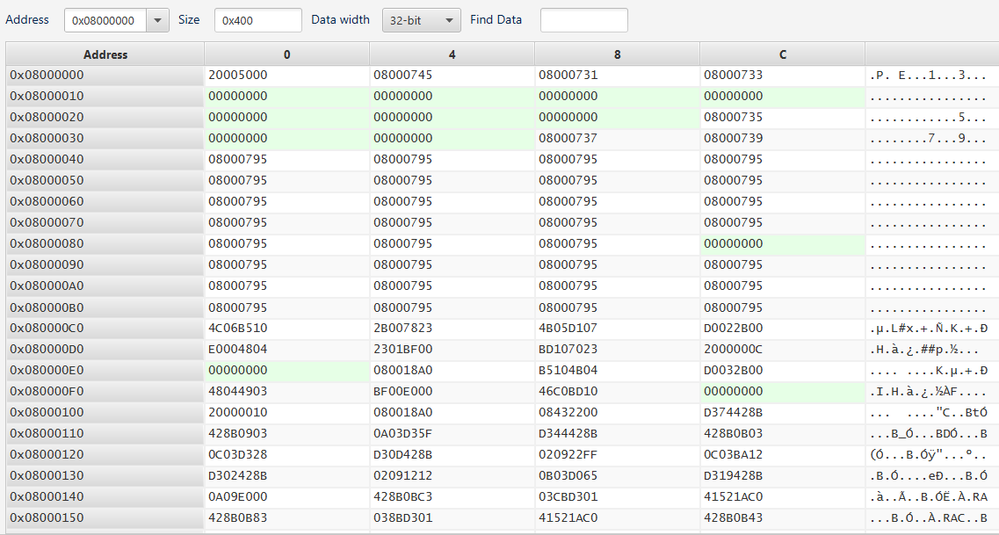

Show the first dozen vectors a 0x0800 0000 and 0x0801 8000
2022-05-03 10:01 AM
Both locations should be identical. I've flashed the same .bin in both locations using STM32CubeProgrammer:
