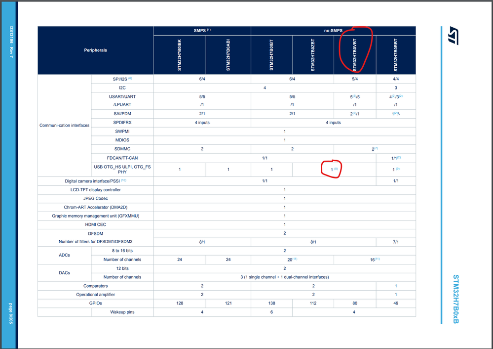

Which STM32H7B0 line are you using ?
According to the STM32H7B0xB datasheet, for STM32H7B0 the ULPI is not supported for 100/144 packages, but This is not applied on all STM32H7 Packages.
I advise you to check the available pins/balls in "Table 7. STM32H7B0xB pin/ball definition", and the note related to ULPI interface availability on packages that do not feature PC2 and PC3 I/Os, in Table. STM32H7B0xB features and peripheral counts.

According to the datasheet, ULPI is available for this 100pin variant...
