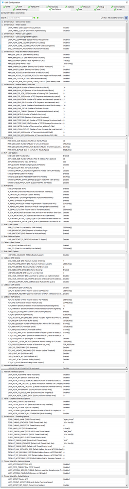

Hi, im using stm32f7+ freertos+lwip (raw api). My system handles web server and udp data communication. My frame length is 572 bytes and my FPS is 40 (22880 bytes/sec) at start. When i increase the package number to 8 times (8*572*40 = 183040 bytes/sec) it drops a lots of udp packages.(Especially dropping starts after 6 times = 6*572*40=137kbits) The weird thing is: if i decrease it to 22880 bytes/sec again it cant returns the normal situation it still drops. I have to reset for normal again. Im not expert lwip so i think there is a problem about buffers. I need an advice.

Thanks again AvaTar for all your replies and helps. I solved it, the problem is ETH_RXBUFNB at stm32f7xx_hal_config.h. Default value is 4U when i icrease it to 16U the phy to dma communication speed increased. But the CubeMX cant change this value with any graphical tool.I must change it manually for every compile.
