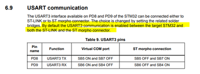

@hdferguson3 wrote:I am using UART2
Is that USART the one connected to the ST-Link ?
eg, https://community.st.com/t5/stm32-mcus-products/uart-doesn-t-work/m-p/759888/highlight/true#M270155

How can I determine that?
2025-01-13 10:25 AM - edited 2025-01-13 10:38 AM
From the board's User Manual and/or Schematics - as illustrated in the linked post/thread

Oops, let me swap to USART3 and try this again!!! I'll report back.

see circuit :
https://www.st.com/resource/en/schematic_pack/nucleo_144pins_sch.zip
2025-01-13 10:35 AM
Boom! That was it. I knew I had overlooked something simple. I followed a tutorial and looking back that didn't overly make clear which USART they picked an why. So, make sure you know which USART to use and why.

You said it's, "an older STM32 Nucleo-F746ZG" - does that mean it's previously been used by you and/or others?
If yes (especially if others have been using it), you'll need to check those solder bridges (SB4, SB5, SB6, SB7)
