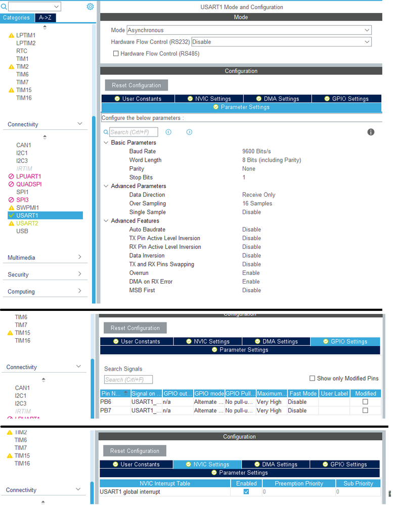

I want to get information from a GPS chip with an UART communication (TX/RX). It works when I use non-interrupt mode with HAL_UART_Receive function form HAL library.
However I want to optimize the code using the function HAL_UART_Receive_IT from HAL library. For now it is not working.
My UART configuration is here :
I only added this code to the generated main.c :

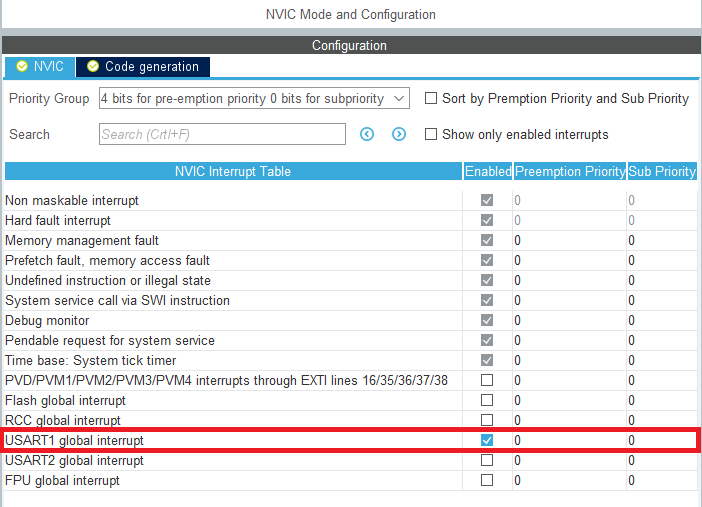

> Priority of UART interrupt is set to 0,0 (see screenshot)
This should instruct Cube to generate NVIC enable interrupt call for the UART . Have you checked that it is generated and called?
