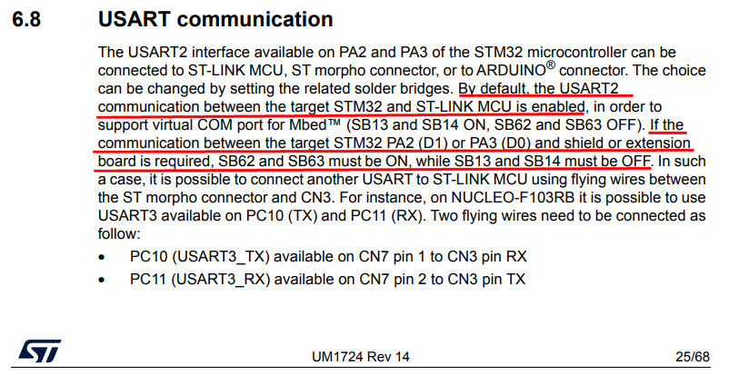

Well, it does say the following:
USART communication
The USART2 interface available on PA2 and PA3 of the STM32 microcontroller can be
connected to ST-LINK MCU, ST morpho connector, or to ARDUINO® connector
It most certainly is configurable, I'm just missing something.

2025-01-18 12:58 AM
Ok, it seems the pins are used for serial connection with my PC over STLink... I will try different pins.
2025-01-21 3:08 AM
@Michael8278 wrote:It most certainly is configurable, I'm just missing something.
and it does go on to say that by default the connection is enabled:
