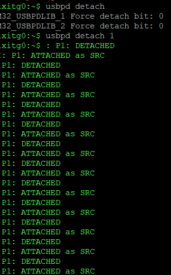

2023-04-06 2:28 PM - edited 2023-11-20 9:05 AM
@nicolas P Thank you for this code and ongoing support. After testing it, when I force the Detach, instead the USBPD code oscillates between Attached and Detached. I've attached my usbpd_cad_hw_if.c file for you to review.
Specifically, I'm unsure where in the CAD_StateMachine_DRP function (not SRC) I need to make edits, and also if the else clause in ManageStateAttached_SRC was implemented properly.
Thank you,
Rob
2023-04-07 1:08 AM
Hello @RHelv.1
I checked you file and if your application is using DRP state machine you need to apply following fix to avoid a new attachment
line 854 of your files
