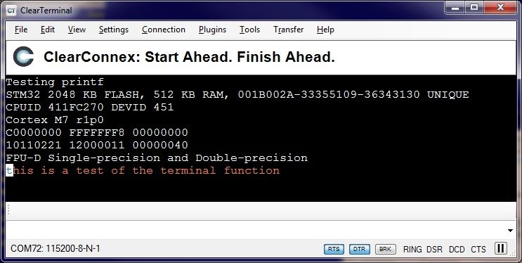

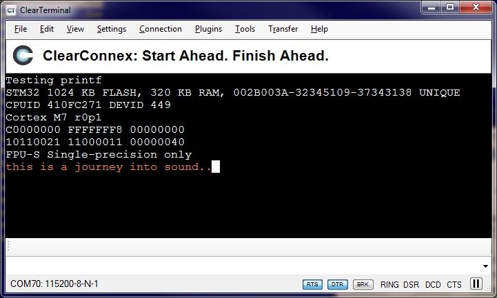

This worked for me on the F767ZI
https://drive.google.com/open?id=0B7OY5pub_GfITEtjaDhzM1BnVVk
And F746ZG, same .HEX
2017-04-10 7:41 PM
If it is not apparent, the F7 goes into USART echo mode once it has output the diagnostic info, ie any thing you type at the terminal at 115200 8N1 is echoed back as received. Seems to be functioning as designed.
