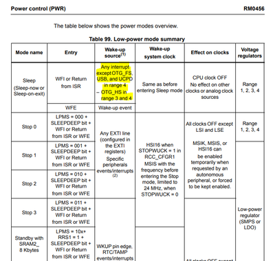

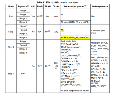

The peripherals that are still active in sleep mode are shown in the below table (From product datasheet)
Please note that OTG_FS and USB are functional in voltage scaling range 1, 2, and 3. OTG_HS is functional in voltage scaling range 1 and 2 as shown in the below picture (From RM)
