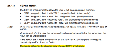

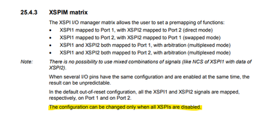

2025-08-25 1:49 AM
Hello @YoungKwan
According to the reference manual the two XSPI interfaces should be disabled before configuring IO manager.

2025-08-28 5:41 AM
Hello @YoungKwan
As mentioned in the reference manual the configuration can be changed only when XSPIs are disabled.
