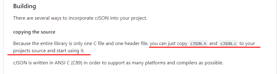

Is there any cJSON library available for STM32?
2024-03-07 5:44 AM
@srikanthpalvai wrote:Is there any cJSON library available for STM32?
Why would it be in any way specific to STM32 ?
Surely, it's just about parsing text - which isn't going to rely on anything STM32-specific?
You can simply dump the source into your project:
https://github.com/DaveGamble/cJSON

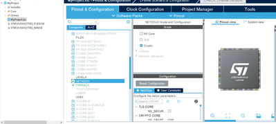

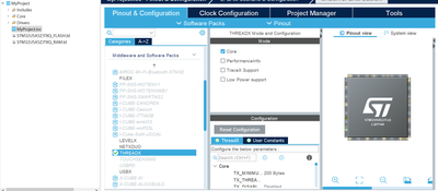

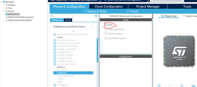

After enabling the core, Netxduo is getting enabled bu why do I enable threadX first?
I found crypto here but it's not the mbed-crypto

Hello @srikanthpalvai ,
First of all sorry for the delay.
answering your requests now :
NetX Duo assumes the existence of ThreadX and depends on its thread execution, suspension, periodic timers, and mutual exclusion facilities. you can get more indepth details on this in this link .
NetX Duo Crypto Module is a lightweight cryptographic library that is designed specifically for use with NetX Duo TCP/IP networking stack. It provides a set of cryptographic functions that are optimized for use in embedded systems with limited resources. The NetX Duo Crypto Module supports a range of cryptographic algorithms, including AES, DES, SHA-1, SHA-256, and HMAC.
