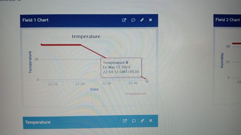

LG.5
Associate II
Hii!
If i connect the DHT11 directly to NodeMCU its working fine and im getting values in Thingspeak
But if i try to send the data from NUCLEOF401RE to NodeMCU then null value is thrown in Thingspeak

On 2024-03-15 04:00 AM, @LG.5 wrote:
Even if I connect Dht11 directly to NodeMCU I'm not getting values in Thingspeak
On 2024-03-15 09:49 PM, @LG.5 wrote:
Hii!
So you've now fixed your problem(s) with the NodeMCU sending to Thingspeak?
So what debugging have you done to find where the problem is?
  1. Is the Nucleo reading the sensor correctly?
  2. Is the Nucleo sending the readings correctly?
  3. Is the NodeMCU receiving the readings from the Nucleo?
  4. etc, etc, ...
It looks  like you're using a UART on the Nucleo to send to the NodeMCU - yes?
If so, you can test that what the Nucleo is sending by connecting it to a PC terminal.
Similarly, you can test that the NodeMCU is receiving by sending stuff to it from a PC terminal.
The thread I linked earlier contains a lot about debugging serial comms - read the whole thread:
https://www.avrfreaks.net/s/topic/a5C3l000000UaFXEA0/t153137
and follow the links...
Please give full details of how the the Nucleo is connected to the NodeMCU - a schematic of the wiring
Please use this button to properly post source code:
