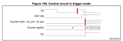

According to the reference manual (RM0440):
30.7.6 TIM15 event generation register (TIM15_EGR)
Bit 0 UG: Update generation
This bit can be set by software, it is automatically cleared by hardware.
0:No action
1:Reinitialize the counter and generates an update of the registers. Note that the prescaler
counter is cleared too (anyway the prescaler ratio is not affected).
Does anyone know what "update of the registers" means in practice?
It doesn't say anything about updating the registers of other timers.

> There seems to be a few microseconds of delay between starting TIM15 (master) and TIM3 (slave) starting. Is this to ne expected? Is there a way to adjust this?
This is expected. It takes some time for the logic to propagate so master and slave will be a few ticks off. It should be the same amount of ticks each time. Two options:
The RM talks about this some.
