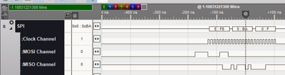

Update:
I've changed some of the code. I now have a responce in my logic analyser that I can see. Problem is that it's not being read as rxdata for some reason and still getting stuck in the loop on [while (!LL_SPI_IsActiveFlag_EOT(SPI1));]
Logic analyser:
Current method:

This is part of my problem, yes. I can verify the data is sent and received on my data analyzer, but the data simply isn't where I'm expecting it. I wouldn't be surprised if it's an issue with a flag not being toggled or something. Wish this particular datasheet was less confusing, haha. I'll take a look into it. The overhead with HAL is the big issue with fast stuff like this. 1MS/s is hard to achieve when Hal takes 2-3 us between toggling the start of conversion and the actual conversion happening.
