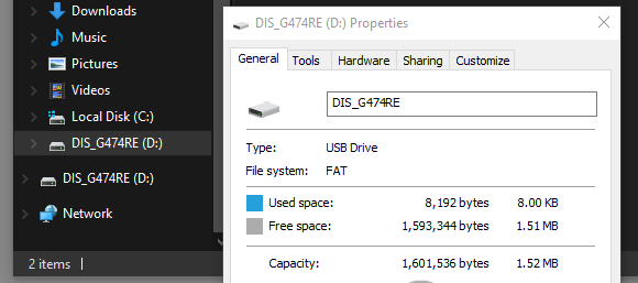

I have noticed that when connecting both of my boards [b-g474e-dpow1, stm32g474ret6u] and [NUCLEO-F429ZI, stm32f429zi] they are recognized as a storage device on windows per the picture below for the b-g474e-dpow1 board.
My question is, these 1.51MB are part of the memory of the onboard microcontroller [stm32g474ret6u] or the STlink debugger or both?
No. It's all done in the ST-LINK. The ST-LINK will flash the firmware, so in the end the .bin file will sit in MCUs flash.
