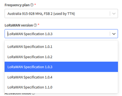

2023-09-27 4:29 AM
Dear @Issamos
I have some questions regarding the proper LoRaWAN standard that should be used on the TTI side and HYBRID_MODE.
In the code I see this:
And on TTI I see these options (with blue is the one I assume I should be using, but I am asking anyway):
Now my question regarding HYBRID_MODE and channels:
The frequency plan, to my understanding means that the gateway will be listening on channels 8 to 15. Is this correct?
From my understanding, during the join process the gateway dictates to the device which channels to use, right?
Is there any reason why would the end node choose to use channels that are not the ones that the gateway dictates?
Would HYBRID_MODE prevent this from happening?
Thanks a lot for your assistance
2023-09-27 4:32 AM
@Issamos
I realize that there is a contradiction between my original question where I am specifying that I am using the 1.0.2 specification.
At the moment the devices are indeed using that spec, but based on the finding in the code we should be using v1.0.3, correct?
In the scenario where 1.0.2 is used though is it normal that the device, after some time that uses the proper 8 channels starts using the other channels that are not being listened to by the gateway?
