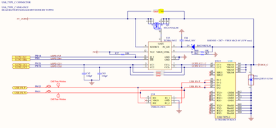

@Riscy, @JMarple1, I got it working, those three posts may shed some light:
I shared complete, working solution for Nucleo STM32U5A5 here:
tdjastrzebski/Nucleo-U5A5ZJ-USBX (github.com)
Just keep in mind board needs to provide USB-C power. For that undocumented SB8-10 jumpers need to be shorten, additional JP6 jumper in 5V_USB_C position is required.
2024-01-21 9:41 AM
Thank, I give a it go :)
2024-01-21 11:03 PM
@Riscy Since more engineers seem to be interested in this topic and ST is not helpful, I placed my solution on GitHub and added some pics tdjastrzebski/Nucleo-U5A5ZJ-USBX (github.com)

2024-01-25 5:38 AM
Hello @TDJ
Thank you for bringing to our attention. An internal ticket is submitted to include these details in HW setup in UM2861 as stated in schematics.
Internal ticket number: 171723 (This is an internal tracking number and is not accessible or usable by customers).
