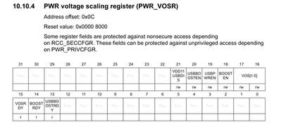

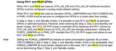

Hello @Yang Yang @Elatewendy
According to the part 10.7.12 of the RM0456, "When PA11 and PA12 are used as standard GPIOs, USBPWREN and VDD11USBDIS bits in PWR_VOSR must be set prior to configure the GPIOs in a mode other than analog".

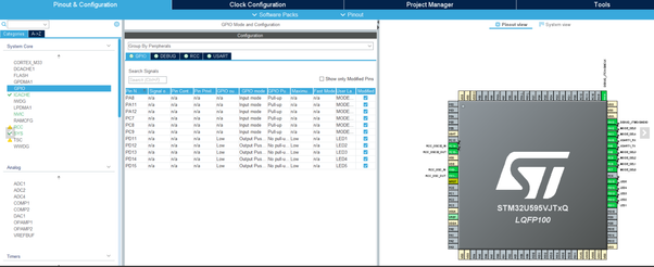

And the gpios configured like this:
