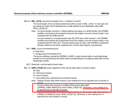

Nonetheless, in this case, the DMA has been set to transfer words at both ports, wasn't it. And the RM says this:
so GPDMA shouldn't have transferred even that one single byte, but should've thrown the user setting error, which doesn't appear to have happened.
