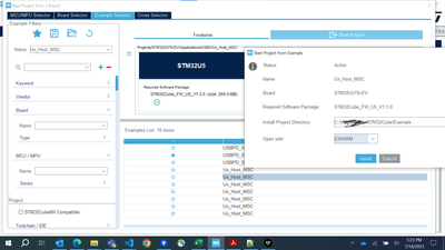

I am using STM32U575i-EV evolution board and trying to run the Ux_Host_MSC example code.
I generated the code using STM32 Cube Mx using example selector option, I generated the code for IAR.
As per the below readme file.
