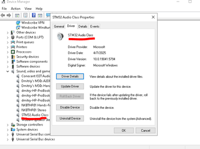

Hi FBL.
Thank you for reply
Already done for initialization of 2 ch USB_FS, at least we got STM32 Audio class in device manger.

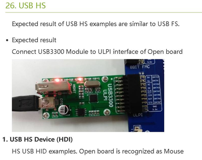

Actually i need RX 4ch, TDM, 16 bit, 48000Hz.  Most probably it will be USB_HS?
Could you please give recommendation for MX config for this,  TLV320adc5140 4 mic CH -- SAI   -ping-pong buffer -- USB_FS_RP4/5.
Thank you for help.
i got this one for USB_HS. do You think we will succeeded?
