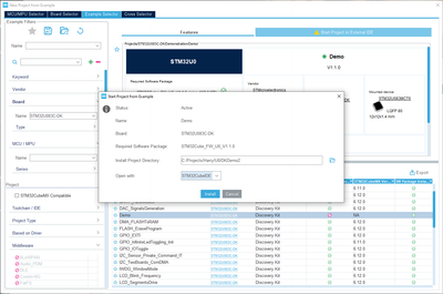

Using STM32CubeMX 6.12.1, I selected "New Project from a Board", Example Selector, filtered by STM32U083C-DK, and selected "Demo".
I chose "Start Project in external IDE" and chose a file path on my hard drive. In this case I chose "C:\Projects\Harry\U0\DKDemo". I chose Open with EWARM.

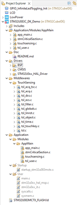

The project was copied to a sub-directory "C:\Projects\Harry\U0\DKDemo\Demo". This is what the first level of files looks like in the Demo folder:

'C:/Projects/Harry/U0/DKDemo/Demo/main_app/app_main.c', needed by 'C:/Projects/Harry/U0/DKDemo/Demo/EWARM/STM32U083C_DK_Demo/Obj/Application/Modules/AppMain/app_main.o', missing and no known rule to make it
The project has an "AppMain" folder that has 4 source files that do not exist anywhere in the copied project.
If I delete these 4 files from the project structure then the Make operation gets slightly further. But then I get stuck at the same place as @RufusVS.

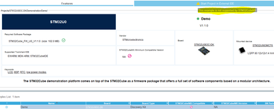

Note that the Demo is not supported by STM32CubeMX, and this mentioned in the warning when chose "Start Project in external IDE". Meanwhile, this will be fixed in the coming releases.

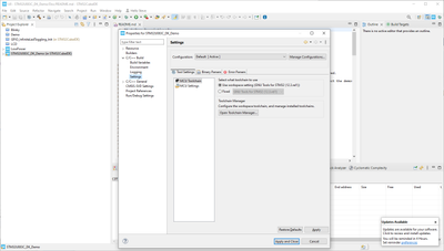

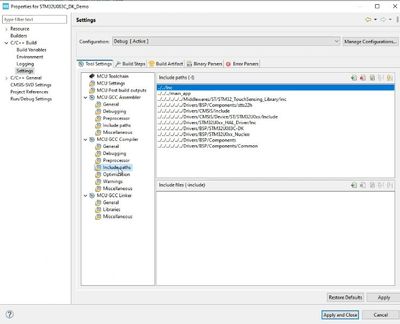

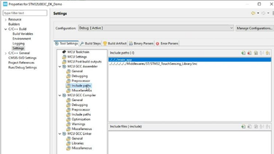

To properly generate the Demo application when open it with STM32CubeIDE, please make sure to have these settings in the Properties of your project:
Thank you for your contribution.

The instructions above do not fix my problem.
I imported the demo fresh from CubeMX.
This is what the project properties look like:

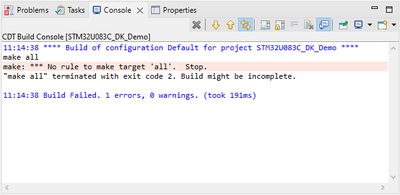

The imported project has no MCU GCC Assembler, or MCU GCC Compiler, or MCU GCC Linker options available.
When I attempt to build from within CubeIDE, there are no build instructions.
The CubeIDE import of the demo project seems more broken than the EWARM version.
