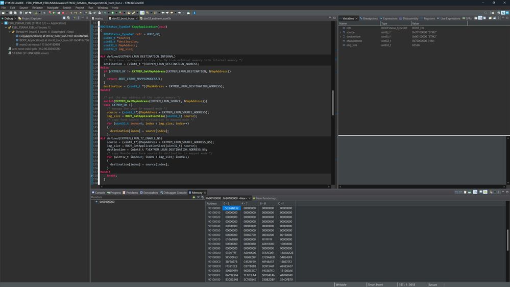

You can debug your FSBL and see what might be wrong, for example, check if the copy from the NOR to PSRAM is actually working. Here I'm added a breakpoint in the FSBL's function CopyApplication, you can see it copied the code from NOR to PSARM:

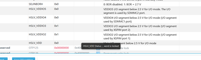

Following is the Snapshot of the OTP fush 124 which is responsible for the I/O segment used by XSPIM Port 1, Port 2.
By the post you have shared, stated that bit 15, 16 needs to be set in order to use XSPIM with higher Clock Speeds.
Still we are not able to run the code in PSRAM. Do you have any idea, Why this is not working. Or it seems like our Discovery kit was blown?

Have you tried debugging the FSBL portion to ensure your copy from external NOR to PSRAM is working? The steps to do that are straightforward, program the two binaries using CubeProgrammer then using CubeIDE enter in debug mode using the FSBL project, that will be loaded in AXISRAM2 and you'll be able to monitor the copy process, same points as I've showed in the screenshots. That will help figuring out which step is not working for you. Remember to have the DK board in DEV mode for the entire process.
