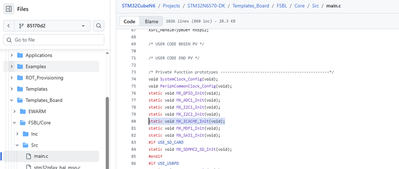

I cannot see MX_ICACHE_Init(); in the example "STM32CubeN6\Projects\STM32N6570-DK\Templates_Board"

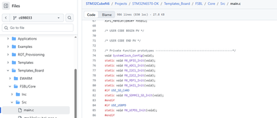

You are correct.
ST released v1.3.0 for STM32CubeN6 MCU Firmware Package 3 days ago (23rd Jan 2026), which does not have MX_ICACHE_Init();. As expected this code runs properly after building and loading to the external flash.
v1.3.0
v1.2.0 does have MX_ICACHE_Init();
Nevertheless the question remains; Why am I unable to use v1.2.0 with MX_ICACHE_Init()?
