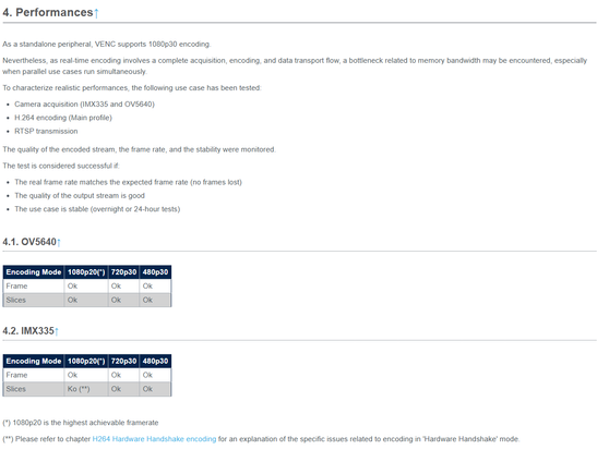

I would like to know the H264 VENC performance for the STM32N6 using the ST example: STM32Cube_FW_N6_V1.1.1/Projects/STM32N6570-DK/Applications/VENC/VENC_RTSP_Server

Hello @FB__1 ;
The VENC IP, integrated into the STM32/N6 device, provides hardware acceleration for H.264 and JPEG encoding.
For more information about the performance, I recommend you to look at
The VENC_RTSP_Server application runs on STM32N657xx devices. This application has been tested with STMicroelectronics STM32N6570-DK boards Revision MB1939-N6570-A03 and can be easily tailored to any other supported device and development board.
I hope this answer your request.
