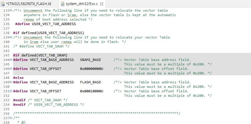

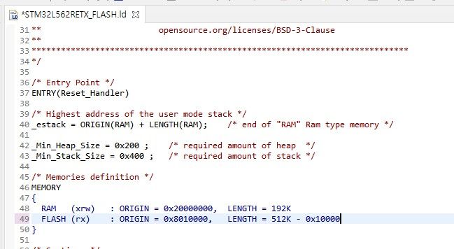

I changed the main code setting like this.
I'm want to jump from 0x8000000 bootloader to 0x8010000 main firmware.
There's an error in the jump.
I downloaded the firmware with a cubeprogrammer.
In this case, how should I solve this?
