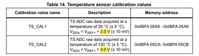

Do you calibrate the ADC on startup?
Does your VREF+ match what was used for TS_CALx? (in datasheet)
2025-03-14 2:47 AM - edited 2025-03-14 2:51 AM
Isn't TS_CAL1 an address? You need to de-reference it first. Also I would invert the slope calculation so you only need to multiply instead of dividing.
If your VREF voltage is not the same you need to scale your voltage or the CAL values.

You are not calibrating your ADC in MX_ADC1_Init(). A common mistake.
Use HAL_ADCEx_Calibration_Start() or LL_ADC_StartCalibration().
Also wait after calibration before starting: https://community.st.com/t5/stm32-mcus-products/adc-register-adrdy-never-sets-when-i-enable-the-adc-so-it-keeps/m-p/106159#M17007
2025-03-14 8:31 AM
> vdda = 3.4V
TS_CAL values are taken at 3.0 V per the datasheet.
So not the same.
Scale adc_temp_raw by 3.4 / 3.0 which gives 1021.
Put that in the calculation and you'll get a temp just under 30 C which is reasonable.
