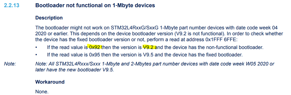

Hello @MSipo,
Have a look to the errata sheet related to the STM32L4R9 devices, to check if you have the same conditions as described in the doc.
It May be related to the section: 2.2.13 Bootloader not functional on 1‑Mbyte devices.
Imen

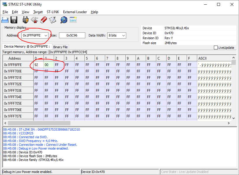

2023-01-29 11:51 PM
The bootloader version is 9.2.
At least I can make it work by restarting the bootloader after a global mass erase before I run any write memory command. :grinning_face:
