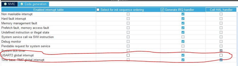

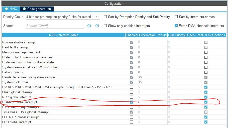

Along with this disabled the " Call HAL Handler " for the USART2 IRQ0693W00000BavyZQAR.jpgAlso modified the IRQ priority0693W00000BawFoQAJ.jpgI have also initialized an queue that is used to send data from the UART IRQ and then received by a task/thread.

Issue:
When I comment out the line:
osMessagePut( USART2_RxQueue, rxData, 0 );
There is no issue encountered. But when the Line is added, the HAL_Init() function does not return.
