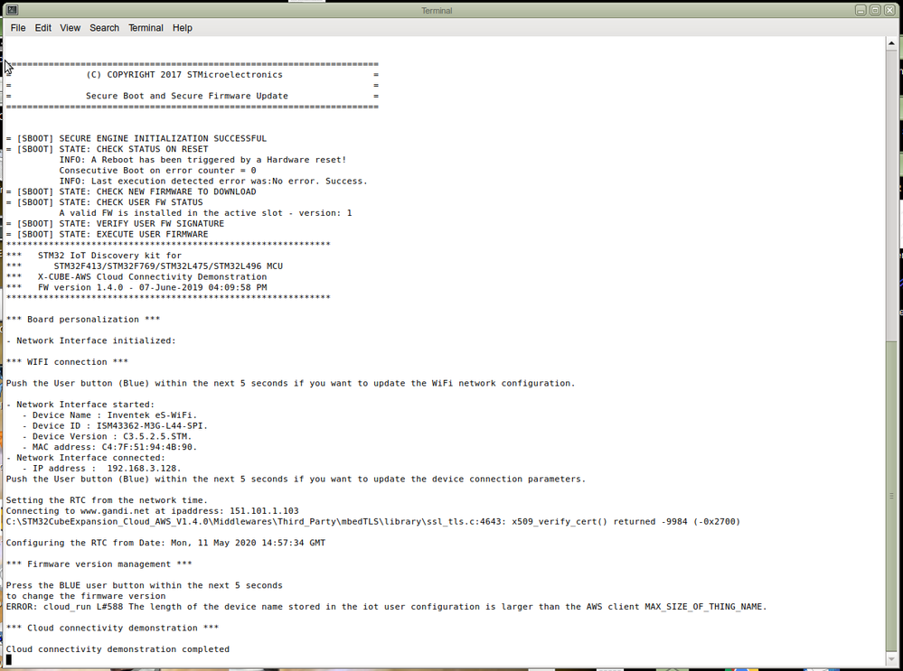

2020-05-11 8:11 AM
Still can't get this thing to connect and display sensor values. Tried many changes to get rid of this X.509 error. No luck.
Any suggestions? Is there an issue with the updated firmware v1.4 and the security config? The recommended connection config to the ST-AWS console just won't work for me.

Hello
The x509 error you are seeing when retrieving time and date is not important. it's just to authenticate the time and date server.
What is important is the error with the name of the cloud device that is larger than the max size. It means the configuration area for AWS connection details is corrupted. it is not possible to connect to AWS cloud.
Did you try to press the board's user button to enter the configuration data when prompted ? (the blue button on B-L475E-IOT01).
To clean the configuration data you can try to erase the full Flash area (you can do this with STM32CubeProgrammer). Then you have to re-flash the firmware and it should ask you for WiFi details.
Or you can try to erase only the area in Flash memory where the configuration is stored. On X-Cube-AWS 1.4.0 for B-L475E-IOT01 it should be at address 0x080F2000 size 12 Kbytes (0x3000). (use STM32CubeProgrammer or ST-Link Utility).
Did the configuration data get corrupted after using the firmware update feature ? What was the previous version of the firmware ?
