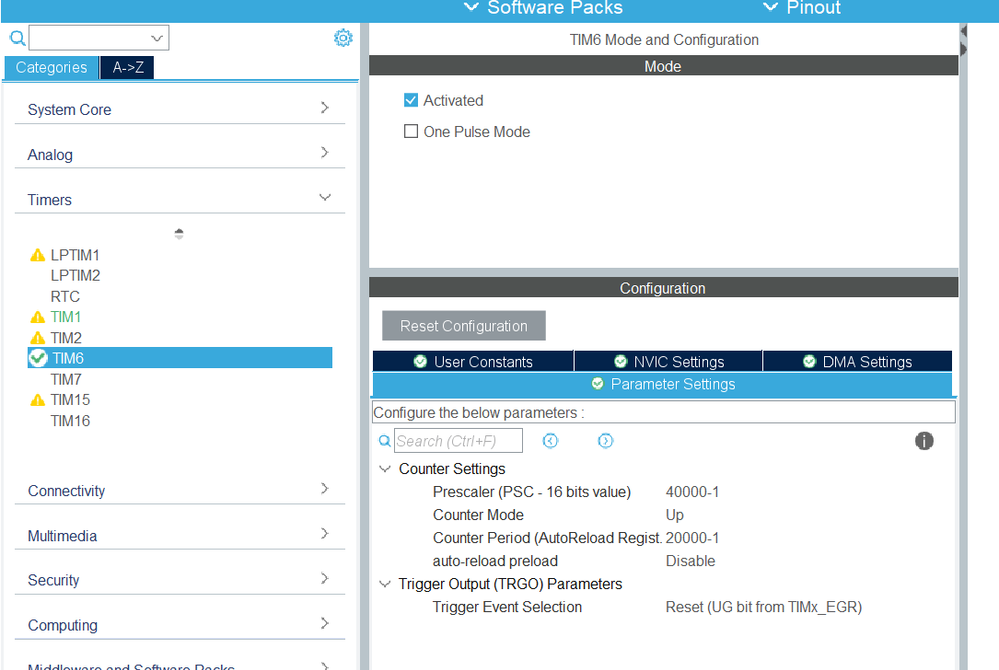

I am trying to send a message through UART based on Timer 6 interrupt on STM32L432KC microprocessor. The prescaler is set to 39999 and the auto reload is set to 19999 to get an interrupt every 10 seconds. When i upload the code, I get the first interrupt 10 seconds in but it never triggers again. I changed timers to see if Timer 6 was clashing with something that I am already using.
I have found that when the Timer 6 counter hits ARR for the first time and interrupt triggers, The TIM6->SR stays 0 but when counter hits ARR for the second time, TIM6->SR turns 1 and interrupt does not trigger which the reference manual says its the flag UIF (Update Interrupt Pending). I was thinking maybe its a hardware issue so tried changing the timers but same story. In the same code I am also doing ADC DMA conversions using Timer 1 interrupt which is set to trigger at 100Hz. That works without issues. The callback function is the same for all Timer interrupts so I am not sure if that has an effect on my problem.

htim6.Instance = TIM6;
htim6.Init.Prescaler = 40000-1;
htim6.Init.CounterMode = TIM_COUNTERMODE_UP;
htim6.Init.Period = 20000-1;
htim6.Init.AutoReloadPreload = TIM_AUTORELOAD_PRELOAD_DISABLE;
if (HAL_TIM_Base_Init(&htim6) != HAL_OK)
Error_Handler();
sMasterConfig.MasterOutputTrigger = TIM_TRGO_RESET;
if (HAL_TIMEx_MasterConfigSynchronization(&htim6, &sMasterConfig) != HAL_OK)
Error_Handler();

2024-07-10 4:48 PM
Debug your code, hit pause, examine where the code is at. More than likely it's stuck in an interrupt somewhere and/or the code you're executing in the callback doesn't have the effect you expect. Examine the state of TIM6->CNT to verify it's still active and counting.
There's nothing wrong with your TIM6 setup that I can see.
> J *req = NoteNewRequest("note.add");
Note that this almost certainly causes a memory leak as you call it every callback, in addition to calling it at the global scope. Can't see the code for it though, so just a guess.
2024-07-10 4:48 PM
2024-07-11 1:27 PM
I did that and It would always stop in a HAL delay which I assumed was from the HAL_delay function in the main infinite loop but apparently NoteRequest never exits waiting the UART to time out so it gets stuck in the very first timer interrupt. I realized after you mentioned that its probably already stuck in an interrupt.
Thank you.
